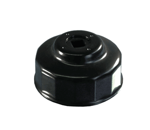

is it a 76mm oil filter wrench you are looking for?
Cooper tools carrys Lisle brand tools, and Lisle does make a 76mm filter socket with 14 flutes (Honda and other Japanese cars) so he could order it in for you.
But Canadian tire, Princess auto and other all sell oil filter wrenches. Just take a stock filter down there and make sure you get the correct one. I have some, the Honda one somebody kept (I have to stop lending out tools). But they are more for just removing hot filter I don't want to touch!
I haven't met a filter yet that I couldn't get off with these
Or my big set of channel locks.
Often there is isn't room to get up beside the oil filter, (Which is why I suspect you want a filter socket) so I open the channel locks all the way up and grab the filter straight from the bottom. Squish it down hard and turn sideways. It will come off. If you can't get it off with your hands now, there is little hope a plastic socket will. They just jump the little flutes on the filter.
The filter will probably look like this when done.
